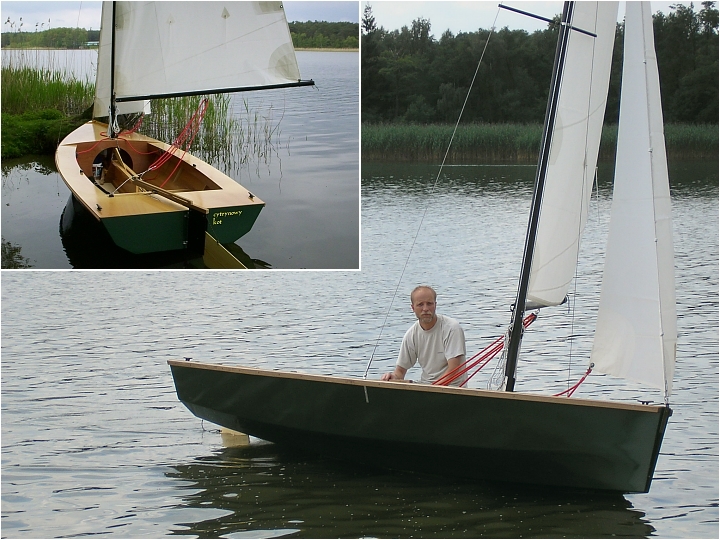

Лодка вот такая. Вы мне по правилам должны дорогу уступать.
А вот где они уже построены и безопасно эксплуатируются. Вот чего я от Регистра хочу, чтоб он это признал без подачи стоса паперів. Собственно и все.
Piotr Miłosz has the hull of his
boat almost ready in two months
- Poland.
Launching day - Jordi Esteve has
built the older flat-bottom version
of the boat (Spain).
Ruslan Gichka has posted
his website, where explains details
related to his boat building work.
Although his boat is very changed,
the builder (Andrei Karpukhin,
Russia) assures me that she is still
the 4.5m dinghy.
A photo sent me from Russia.
Gerardo Alonso's boat under
construction.
Liam A Morgan: last Sunday was
the first time our boat sailed under
her own power.
It was an unusual experience to
lift the new dinghy down from the
second floor - Nikolay Travnikov,
Russia.
Simeon Stoilov's boat just after
spray varnishing the deck.
Tomasz Kozłowski started up
from the centreboard and rudder,
and completing the rig. Now the
work on his boat is well advanced
- Poland.
In the picture the bow of the
boat is pointing to the Irish Sea
which is 2 km away - Mike Bolton,
North Wales, UK.
The boat in competition with
a Pirate-class dinghy - György
Sáfrán, Hungary.
The boat being built by Santa
Cruz Alejandro Dario in Buenos
Aires, Argentina.
Gonzalo Olivera of Argentina
is quite advanced in building
his boat.
Martin Allietti hopes to finish
his dinghy before summer time.
Brent Schutz spent a great deal
of time browsing for a boat to suit
his needs - Minneapolis, USA.
Paolo Pallotta of Italy has
his dream come true...
Simon Miles is currently building
the sailboat in Seattle, USA.
The following boat has been built
in South America by the three
friends: Richard, Alvaro, and
Sebastian.
The dinghy I had designed and
built before the 4.5m was four
meters long and more racing.
One of them was built perfectly
by Michał Mróz in Poland, and
another one by Čedo Perić in
Croatia.
http://www.dinghy.pl/45m_dinghy.htm
Назва:  45m_photo.jpg
Переглядів: 544
Розмір:  339,9 КБ
